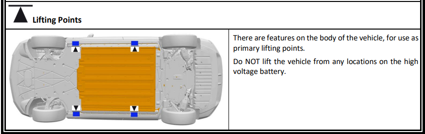

I just found this online. It’s from a bulletin that went out to first responders and it identifies lift points on the Equinox EV.
After looking under my vehicle, I see where the lift points are for using a floor jack. I’ll need to pick up those slot style jack pads referenced in post #25.

I found an Equinox EV emergency response guide which shows that there are lifting points on the body along the rockers. These are typically marked with a half-moon cutout in the rocker flange. This used to be something that would be shown in the owner's manual. Possibly since GM doesn't provide an emergency jack, they don't specify where jacking should be done. It may be that GM prefers the vehicle be lifted using a hoist on all 4 lifting points, but that's not how I will rotate the tires in my garage.

I just had winter tires put on my Equinox however, because the tire shop had never worked with an EV, they asked (me) if there was a lift kit(?) they should use, or whether their hydraulic lift would work… and how it should be set.
If they used the shop’s lift, is there anything I should be concerned about? They had called the local dealer & apparently it would be ok.
I’ve shown them the lift point diagram, but want to be sure those were ok for their equipment.
Was it??
What they need to know are where the lift points are (the pinch welds) and the car weight 5k lbs. Neither should be a problem. The slotted hockey puck saddle shown above give a good idea of what's involved.
