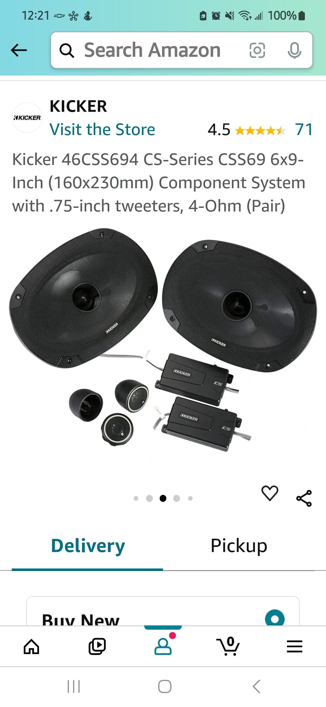

No. See attached. Mine are Kicker 900 watt component speakers.No photos of the new speakers installed? Any mods needed or straight screw in? Door panels east to get off? Are these the ones you got?

Nice, I got the ones in the screenshots, rears are done, fronts going in today.No. See attached. Mine are Kicker 900 watt component speakers.

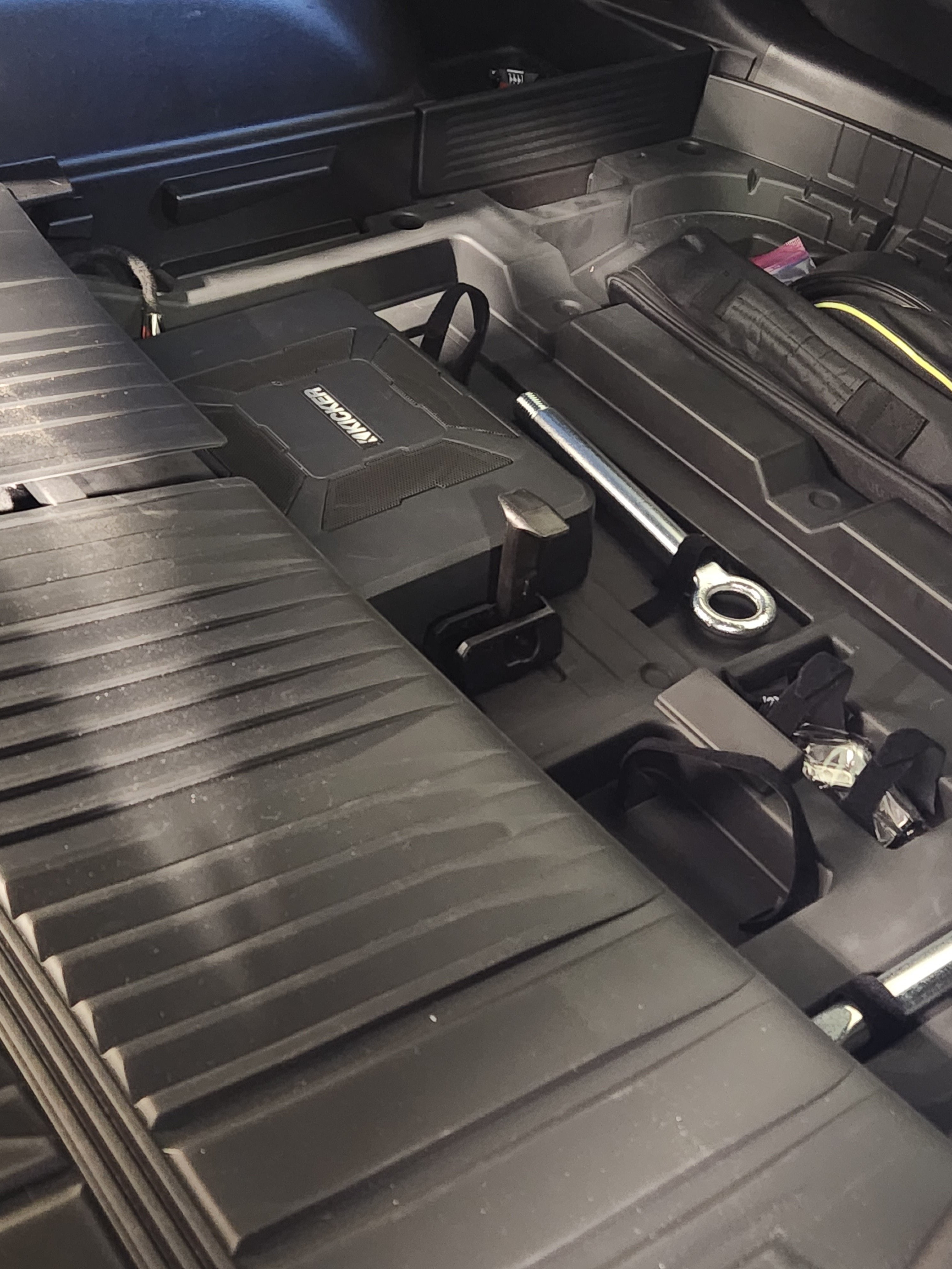

Update: i had my sub placed in the cargo area underneath the carpet floor that lifts up. My sub is very slim and fits nicely on the cargo tools tray. With the carpeted floor on top which is nicely flush.where are you stashing the sub?
Yup that's where it is.That small storage area below the cargo cover is perfect.
you said you had bestbuy do this?Here are some pics installing the powered Kicker subwoofer 8 inch hideaway unit. All being professionally done. B
Yes.you said you had bestbuy do this?
Let us know how it sounds. I felt it a significant improvement. You can really hear the mids and treble sounds.. it no longer sounds muffled. When you add a powered sub you will get some nice lows bass sounds.Nice, I got the ones in the screenshots, rears are done, fronts going in today.
