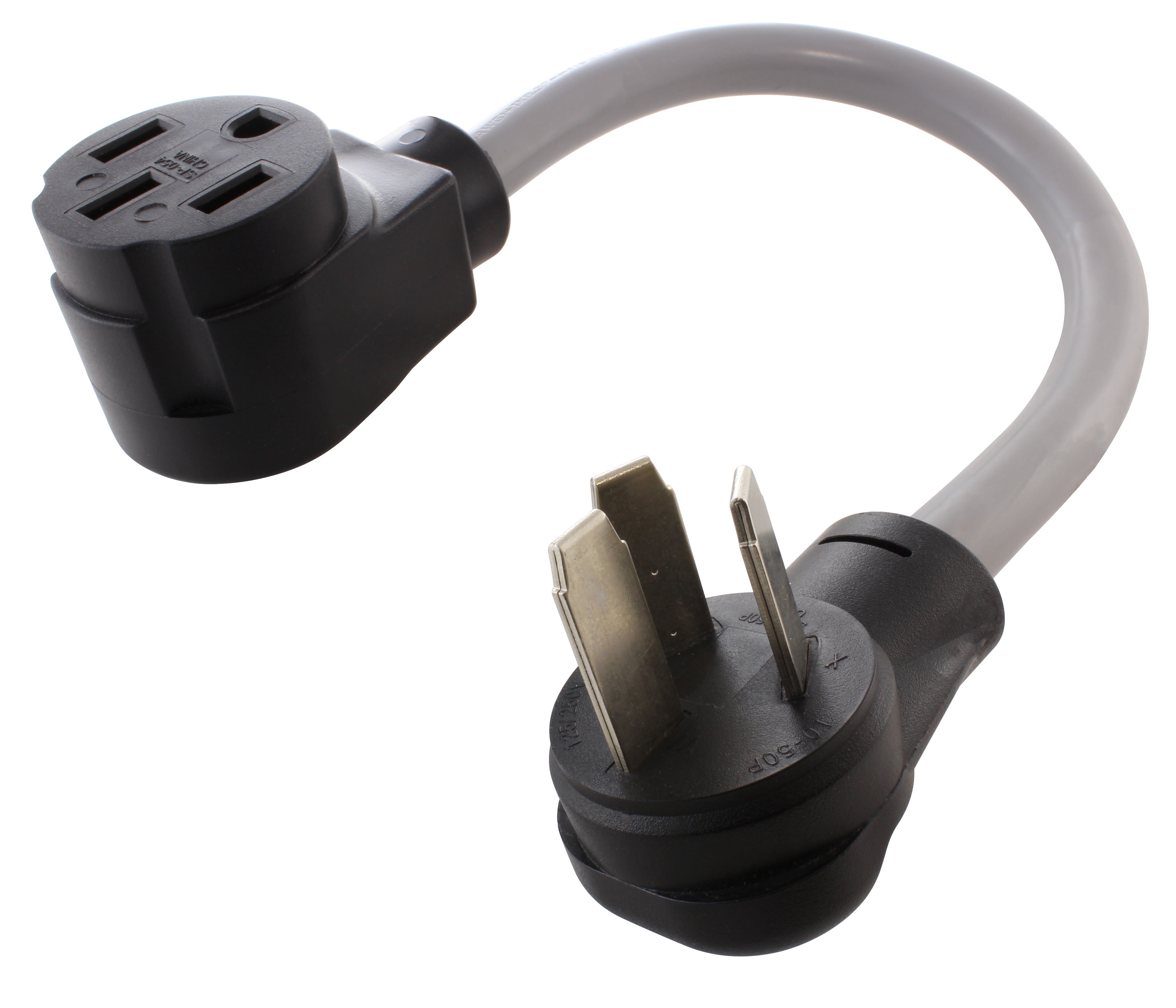

Is this ok to use or would I need the one with the ground wire.
What this not just for the house that will be temp as are putting in a level 2 having 2 EVS.
But for on the road as well as a just in case.
Thanks for the help- tell me if I should post this elsewhere.
Check on GM site. They sell one too.

#140 ·
Finderomend 4 Prong Dryer Y Splitter Cord
Yes, like many it looks promising at first glance, but:
  • They show the ends in the rain, lol. No protection from death by electrocution that I can see. Extremely lethal for outdoor use as shown.
  • No lookout protection to prevent causing a fire by using both the dryer and the car EVSE at the same time. This can easily cause an accident (smoke, melting plastic, fire).
  • And this "Remember to adjust your charging rate to prevent overheating or circuit breaker triggering" which the Ultium EVSE can't do.
I would strongly recommend against this type of solution. The proper and safe way for something like the dryer illustration they show is to install a second 2-gang electrical box for the car with the 240V receptacle controlled by a 240V DPDT switch that either powers the dryer OR the EVSE, but NEVER allows both at the same time.
For outside campground use, you need a waterproof (think marine use like a boat dock) connection between the EVSE plug and the adapter. Again 240V is lethal.

Can I plug into my electric clothes dryer outlet instead? Probably. An optional kit (GM Part # 84877187) with other plugs is available for plugging in to NEMA 5-15, NEMA TT-30, AND NEMA 14-30 outlets. These and other related parts are available at AC Delco directly or through GM parts sellers
