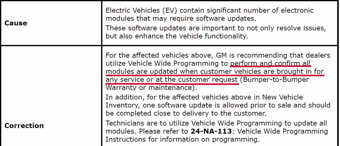

How To Get SQBR6 Update
To get your infotainment system updated,
  • make an appoinment and request TSB 24-NA-143: Vehicle Wide Programming (VWP).
  • The TSB should be done by the dealer any time the car is in for service, or at your request as a part of the B2B warranty. So push back and show the TSB if they drag their feet and try to get out of it.
The VWP involves the dealer checking various modules and updating them. This can take time (hours) if this is the first service visit and there a various modules to update.

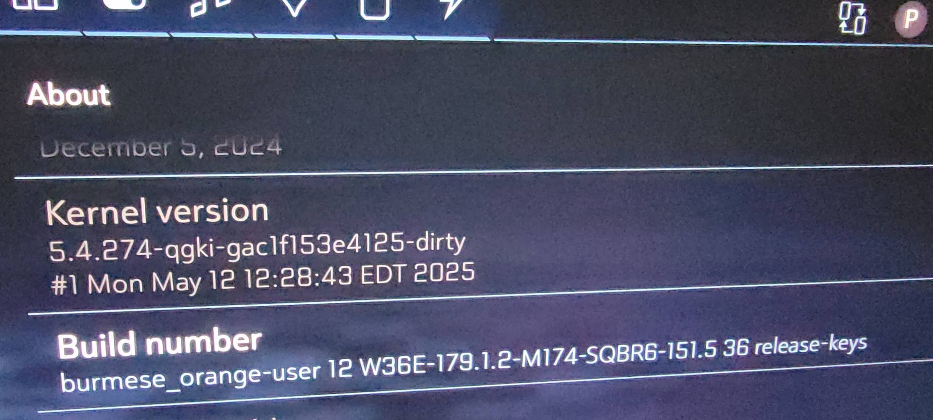

Verification
If the dealer does it correctly, it will show "85876837.mnf" under your updates history. It should also show "SQBR6 151.5 36 release-keys" when you go to the "Settings->System->About screen". See attached pics.

When done it shows in the "Settings->System->About screen" as Build number:
“Burmese_orange-user 12 W36E-179.1.2-M174-SQBR6-151.5 36 release-keys”
