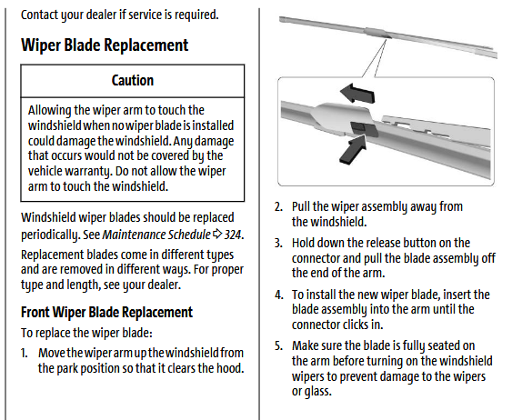

Installation is covered in the OM as posted by DanJustDan:
ExtraSharky said "To install, there isn't anything particular about it. You literally slide the wiper blade onto the wiper arm and there's a small "click."
(If you or someone has a video showing this let me know and I'll post it here as well.)
