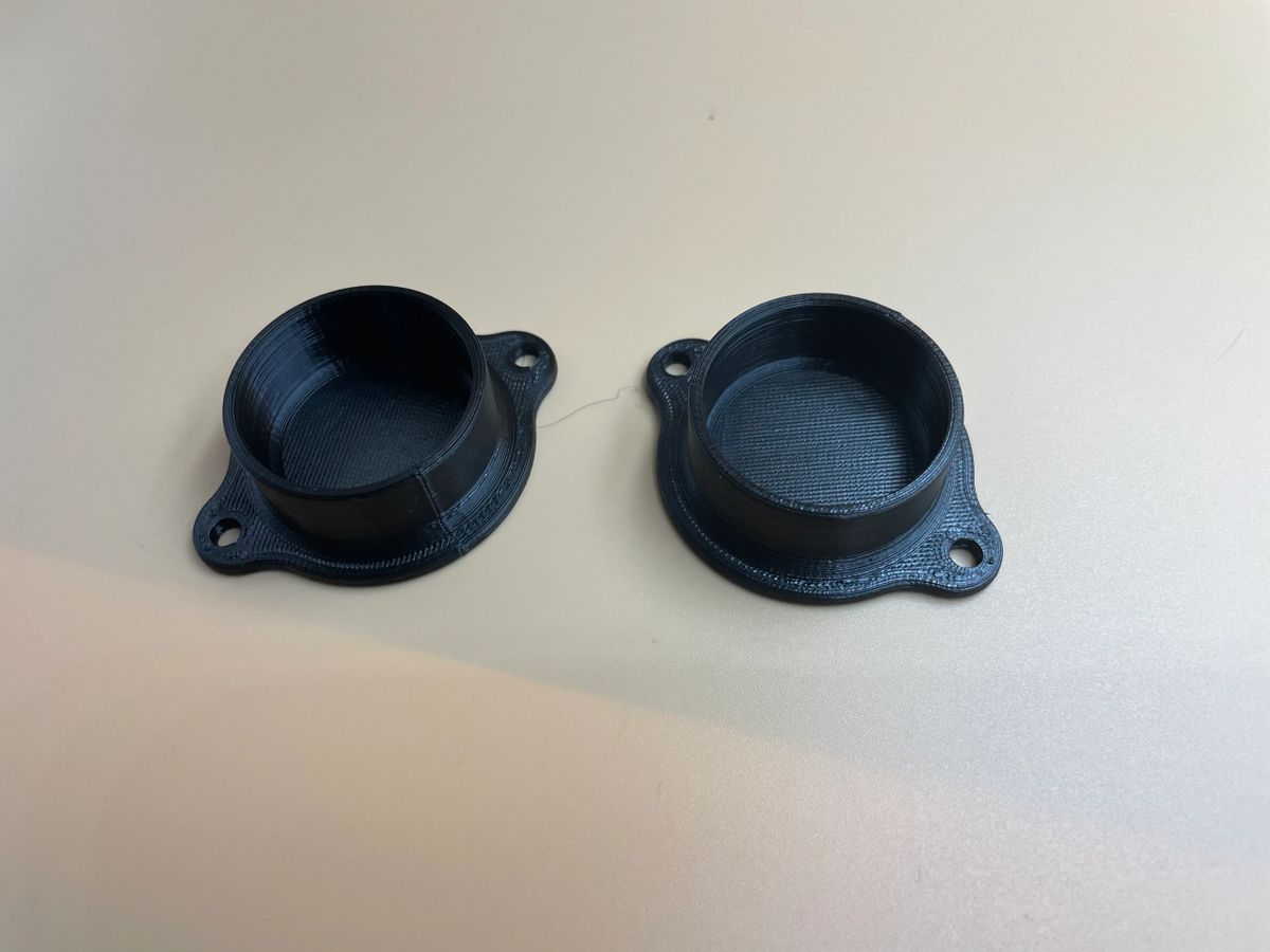

#8 ·
You're american so you can buy these:
